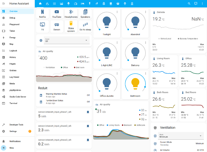

Stylish and easy to use dashboards for your Velbus installation
Home Assistant shows you your Velbus installation in a easy and clean overview, grouping your controls in their corresponding room. Controlling devices, light points, LED strips, thermostats, blinds, etc. is a breeze with the touch-to-change interface. It doesn't matter if you use your smartphone, tablet or smartphone, it always looks good!

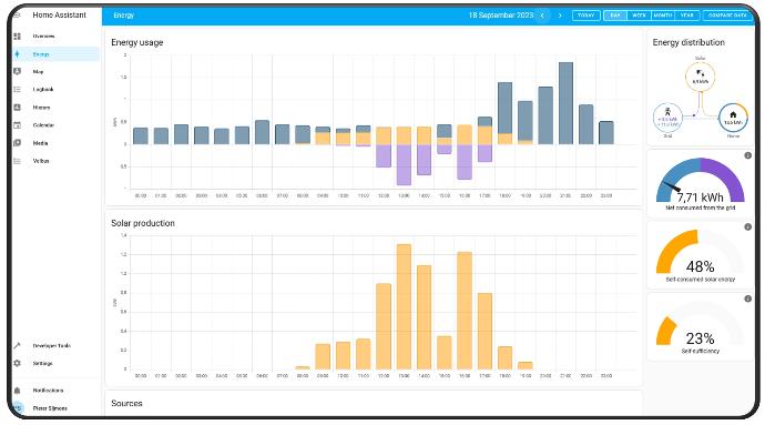

Visualize your energy use
If you have an energy meter in your Velbus installation, comprehensive energy dashboards are a must have in your Home Assistant setup. Have a look at detailed graphs to better understand your energy consumption and use it to optimize your lifestyle and energy bill!

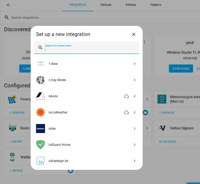

Link your smart devices with Velbus
Home Assistant will be your central hub to link all your smart devices in your home. Via integrations, you can link with over 2.500 smart systems, enriching your dashboards with their data and creating smart actions between devices that couldn't talk to each other before.
Your heating pump (MELcloud, Daikin, Viessmann ViCare), charging station for your EV (wallbox, Smappee), sound system (Sonos, Spotify, Bose SoundTouch, IKEA SYMFONISK ), smart lighting (Philips Hue, IKEA TR√ÖDFRI), smart plugs (Tuya, Shelly) are just a few examples of integrations that are possible.

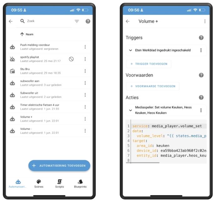

Create smart automation actions
With Home Assistant you can link physical buttons in your Velbus link installation to trigger actions with other integrations.
For example, if you have favourite radio stations that you want to listen to without reaching for your phone, that's a few automation clicks away!
First, create the buttons with their names in your Velbus control panel and then use automation on that button to select an online radio station, playing it on your connected smart speaker (e.a. a Sonos wireless speaker).

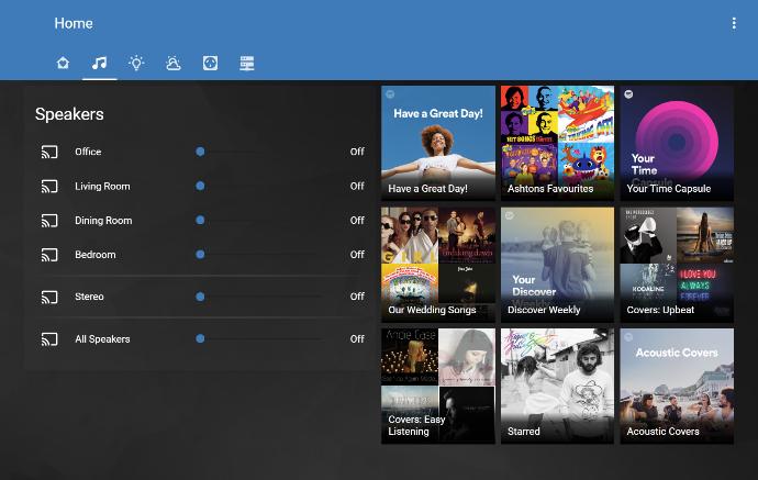

One place to control your sound
One you have linked your smart speakers and your Spotify account, you can use Velbus to control your playlists! Create next track, previous track, volume+, volume-, play/pauze buttons on your Velbus control panels and link them via automation actions together. Finally one place to control your home's music entertainment.

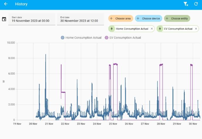

See what happens and what happened
Thanks to the local data capture of home assistant, you can go back in time by looking at your home's history reports. Never miss an event that happened or when a certain button was pressed. Offering comprehensive hourly, daily, monthly and yearly overviews, you can analyze your behavior and automate actions to elevate your smart home.

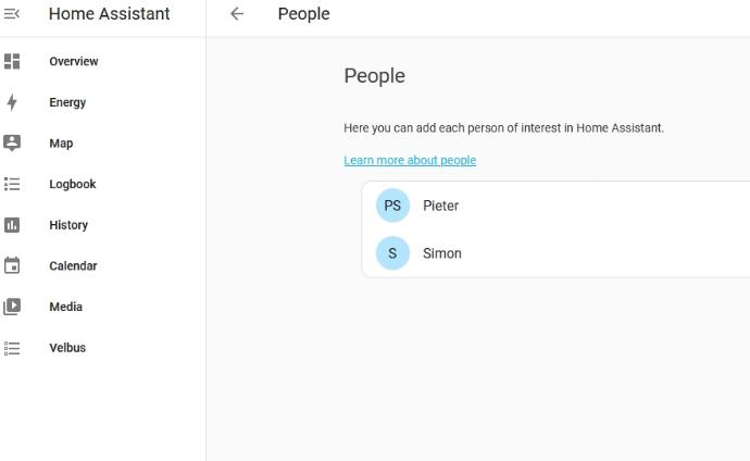

Easy user control
Add users and give them access to selected dashboards, making sure your family can use your smart home installation like you want it.
Each user can create their own experience, making sure the remote control of your home is tailored to your needs.
