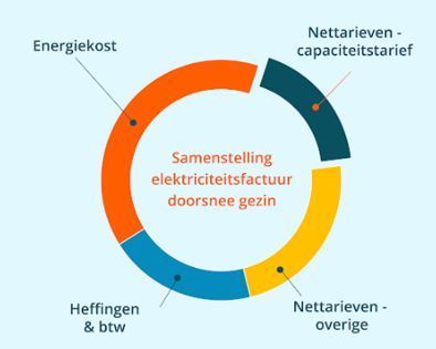

Capacity rate
Starting January 1st in 2023, the capacity rate will be in effect in Belgium. This means that not only your energy consumption, but also your peak consumption for 15 minutes plays a role in the electricity bill.
Odoo • Image and Text
An example: you come home after work, set the heating (heat pump) to a higher setting, and start cooking. After a while, you also turn on the oven. At that time, your house will consume a large amount of energy and therefore cause a so-called 'peak'. If you maintain this peak for more than 15 minutes, this will be charged on your electricity bill for that month, even if you use less energy outside of this moment!

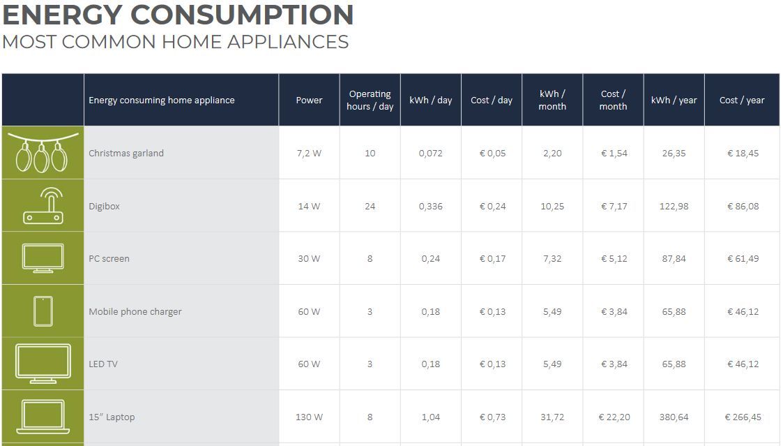

With the above examples and an energy price of ‚Ǩ0.7 /kWh (Sept 2022, incl. VAT & taxes) this gives the following bill to use the devices below for 1 hour:
Christmas garland           8 W           8/1000 kW * 1h * €0.7 /kWh          = €0.0056
Smartphone charger      60 W        60/1000 kW * 1h * €0.7/kWh         = €0.042
LCD TV                              250 W      250/1000 kW * 1h * €0.7€/kWh    = €0.175
Induction hob                  4 kW         4 kW * 1h * €0.7 /kWh                        = €2.8
Oven                                  3 kW         3 kW * 1h * €0.7 /kWh                        = €2.1
Heating pump                 3.5 kW      3.5 kW * 1h * €0.7 /kWh                     = €2.45
EV charger                        11 kW         11 kW * 1h * €0.7 €/kWh                    = 7.7 €
Of course, these are all small amounts, since you only use this device for 1 hour. Suppose we were to calculate this on an annual basis, this would give a better picture of how much each device costs you annually. We have created an overview of the most common home appliances (click on the picture for the full list).

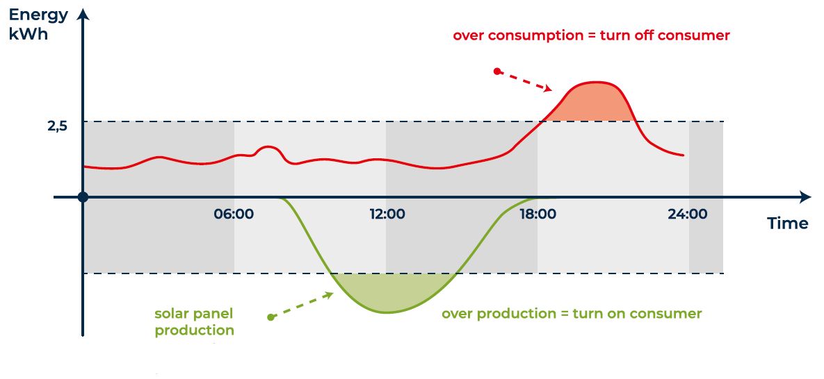

Peak consumption looks at the highest energy consumption peak during 15 minutes within a full month. In the example above we calculate 3.5 kW as current consumption for the heating, 4 kW for the hob and 3 kW for the oven. Together, these devices will have a peak consumption of 10.5 kW. Suppose you are also charging your electric car at the same time, then an additional 11 kW will be added. Good for a joint consumption of 21.5 kW.
Due to the capacity rate, the network tariffs on your electricity bill will also be calculated with this peak consumption. You can make significant savings to your bill by spreading the use of big electrical consumers and controlling your energy usage. In the example above, it is advised to postpone charging the electric car until you are done cooking. And Velbus can easily help you to automate this.

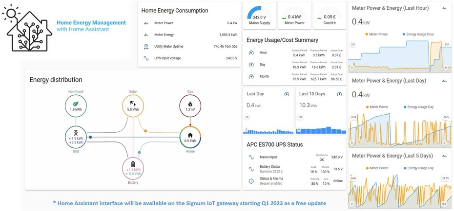

The Velbus energy solution offers an easy-to-understand visualization of your energy situation by showing 3 colors on the Edge lit control panels with or without an OLED screen:
- Green for injection into the electricity grid
- Orange for consumption between 0 and 2.5 kWh
- Red for consumption from more than 2.5 kWh
It is possible to personalize the colors via the free Velbuslink configuration software, so that they are tailored to your unique energy situation.

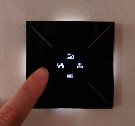

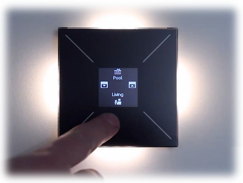

Furthermore, the control panels display the current energy information on the OLED screen (the current consumption/injection in W), depending on which situation is active at that moment. If additional counters (like solar panel production) are added, they can also be visualized. The control panels contain an internal clock & thermostat, so that you can control heating or cooling systems if you add additional relay modules to control the HVAC system.
The Velbus control panels are installed in central places in your home (for example in the living room, kitchen, office, night hall, etc.), so that you get a clear view of your consumption in the blink of an eye. When switching on or off consumers, you see the color of the panels change instantly, so you know what influence the current situation will have on your bill.
You can take immediate action to improve the situation, for example by switching certain consumers on or off. In the previous example, you can choose to temporarily switch off the heat pump when cooking, so that you spread the consumption and the peak consumption is a lot lower than before.
If you also choose the control option with Velbus, switching consumers on and off can be done from the control panel that gave you the consumption warning. Each consumer can have their own page, so you have a fast and reliable way to control your devices.

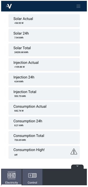

Visualizing the energy situation is a very powerful tool. Where other systems opt to only report via a smartphone application, Velbus chooses to bring this information to your living room, kitchen, office so that you have an instant view of the energy situation and interaction is possible to make smart decisions. This way you won't get nasty discoveries on the energy bill afterwards. Because Velbus is a modular system, the control panels can also be used to operate light points, appliances, link with other systems, etc., so that they really contribute to a smarter living.
With the addition of the Signum IoT gateway, you also get the option to remotely consult energy information and switch devices on and off. From March 2023, energy dashboards with detailed graphs will be available via an update thanks to the Home Assistant integration. This update will be available free of charge on new and existing systems.

In addition to visualizing the energy situation, we want to avoid over consumption & over production situations and turn consumers on and off automatically based on the active energy situation. With Velbus, it's a piece of cake to accomplish this.
For example, the charging of the electric car only starts when the consumption of the home is lower than a set value, so a combined peak consumption will be avoided.
And vice versa, of course: if there is a lot of solar panel production, consumers (such as heat pump and air conditioning) can be forced to switch on, so that the energy is used at the moment it is produced. This way, your consumption and injection are spread out and you keep peak consumption and energy bills under control.

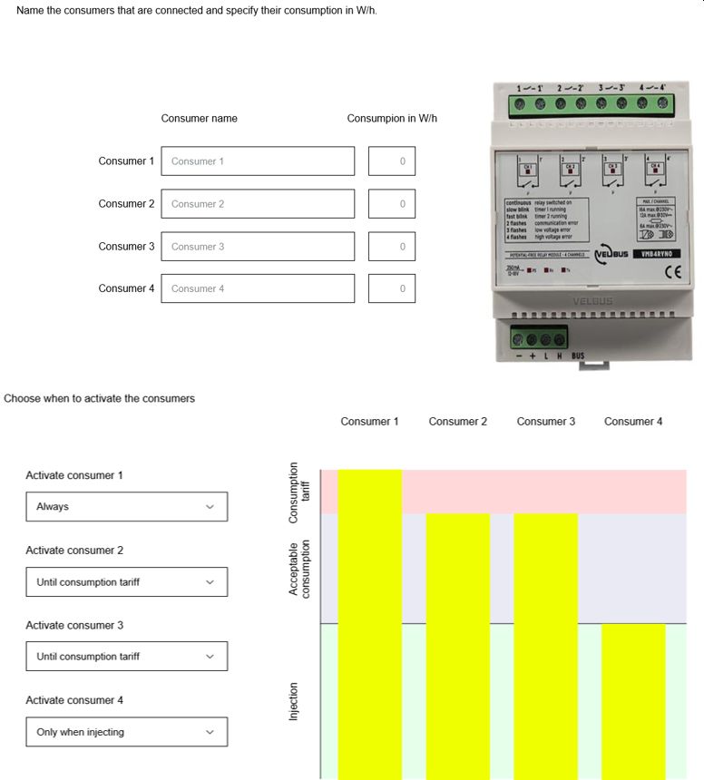

Velbus achieves this with relay modules that can control up to 4 consumers individually. Via set rules, the relay module is programmed when to turn the consumer on or off. This configuration is done by following a wizard in our free configuration software Velbuslink. You specify how a certain device is controlled based on pre-set situations: always on, only on when consuming under a specific level, only on when injecting or only on when injecting above a specific level.
You make a connection between your PC/Laptop and the Velbus installation via a USB connection and the USB configuration module or wirelessly via the Signum IoT Gateway module.
If control panels with OLED screens are present in the Velbus installation, a separate control page can be provided for each consumer on the panel, which you can take over manually if the automatic configuration is not useful at that time.
For example: the configuration is set so that the electric car will only charge if the consumption in the home is lower than 6 kW.
If you are cooking at that moment, there is a total consumption of 8 kW, so the car will not charge. If you want the car to charge in a certain case, you give a command via the control panels so that the standard configuration is temporarily ignored and the car still charges. Of course there will a peak consumption and you will pay more, but that is your own decision.
This way you have an automatic system, but you always stay in control of your installation.

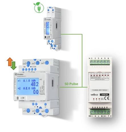

To start, Velbus records the current energy situation via the pulse input module that receives information from the bi-directional energy meter (which is placed after the main fuse). This information is then communicated via the bus network to other Velbus modules. In our energy solution, we report the current energy situation via the control panels with edge lighting and OLED screen. Depending on the linked energy meters, the shown information is the current, daily and annual data of energy production, energy injection and energy consumption. Lastly, the consumers (via relay modules) are switched on and off automatically based on the current injection and consumption of energy. You set these rules yourself via the wizard in our Velbuslink configuration software.
The technical diagram below contains all building blocks for measuring, configuring, smart switching and visualization with the Velbus control panels. Further expansion of this system into a complete building management system is of course possible. Velbus guarantees lifelong expandability, so you can let your system evolve along with your home or installation.
Starting from the left side:
  • FIN7M.38.8.400.0112 bi-directional energy meter that measures both injection and consumption and forwards this to the Velbus input module VMB7IN via pulse signals. Note the connections, each pulse channel is taken in twice on the input module.
  • VMBPSU-2, the Velbus power supply with associated fuse. A 6A fuse is sufficient.
  • VMBRSUSB, the configuration module that allows you to configure the Velbus installation via USB connection to your laptop/PC and the free Velbuslink software. Did you also add the VMBSIG IoT gateway? Then you do not need this module and you can connect wirelessly to the Velbus system.
  • VMB4RYLD 4-channel relay module, which can switch 4 channels with a max load of 230V 16A (total load).
    Warning: For heavy consumers with capacities > 3.7 kW (such as an EV charging station) an additional contactor is required, such as the Finder 22.44.0.230.
  • VMBELO control panel with OLED screen for feedback & operation of the Velbus installation/devices.
  • Additionally, the IoT gateway (VMBSIG) (not shown in the picture) can be added for online operation and reporting.

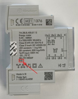

At the request of Velbus and the Belgian market, Finder has made adjustments to the 7M.38.8.400.0112 bi-directional energy meter (FIN7M.38.8.400.0112). These modifications allow simultaneous use of the S01 port and S02 port to communicate consumption and injection via pulses to the Velbus energy management system.
These adjustments have been executed for modules produced after May 2022. There are still old modules of the 7M.38.8.400.0112 available worldwide that do not have this adjustment. These modules do not allow reading of injection via the S02 port and are therefore not suitable for the Velbus energy management system if you have solar panels or other forms of energy production in your installation.
To make sure that you have a Finder 7M.38.8.400.0112 energy meter that has received the necessary adjustments, you should check the production number. You can find this on the left side of the module or on the item sticker of the packaging.
The production number always starts with a letter for the year and 2 digits for the production week. In the example above, this is N51 (year 2020, week 51). Only energy meters with a production number P19 (year 2022, week 19) or higher (P21, P29, Q3,...) contain the necessary adjustments for reading via the S02 port.
For example, old modules of the 7M.38.8.400.0112 have a production number N49, N51, O20, ... If you find such a module in your Velbus energy set (VMBEMS1W, VMBECS1B or VMBECS1), or if you have purchased the module via Velleman, please report this via our ticket system  help.velbus.eu. We will then arrange a free replacement of the module for you.
If you have an old module that was not part of a Velbus energy set or was not purchased via Velleman, we ask you to contact your point of sale.
Is the module already installed and impossible to check the production number? If you are using the Velbus energy management system, you can check whether the LEDs at position 3 and 4 of the Velbus VMB7IN module light up during injection (solar panel production > local consumption). If this is not the case, you probably have an old module and it needs to be replaced.
